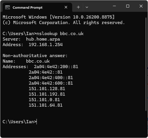

Just been migrated from Plusnet to EE today, and everything went well but I just noticed something a bit odd when I came to do an nslookup from my desktop.
Basically, if the DNS servers weren't specified, the request would time out and you can see the address that pops up in the first nslookup is the IPv6 global unicast address.
The only difference I can see from my old PlusNet hub is IPv6 is disabled on that, and enabled on the EE one and it doesn't look like it can be changed.
You can see in the second example, I stipulate the default BT DNS address 81.139.56.100 used by my hub, and it then works. Ditto, if I specify the Google DNS server 8.8.8.8.
Hub is SH31B running r4.26.2-R-1923137-PROD-83002
Any ideas? Thanks.

Just checked my hub and it seems to have updated itself and FW is now showing as r4.26.3-R-1923144-PROD-83002 but still seeing the same issue.
on 22-07-2026 02:17 PM
@YorkshireMidge It's worth doing the 5 minute power off reset to the EE Hub, then seeing what is going on when powered back up again from the fresh restart.
on 22-07-2026 07:19 PM
Issue resolved itself after a factory reset of the hub in connection with another fault I had (see https://community.ee.co.uk/t5/Broadband-Landline/Migration-from-PlusNet-to-EE-CCTV-port-forwarding-i... ).
I now see nslookups resolved without any timeouts and without having to specify the DNS service.
