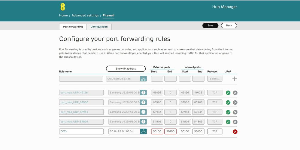

@JimM11 Hub has updated itself to r4.26.3-R-1923144-PROD-83002 but still seeing the same issue.   I have noticed something odd though. When I put the forwarding rule in, if I go back to it after successfully adding it and saving it, and put my cursor in any of the port boxes for that forward rule (internal or external, it doesn't matter), the two external boxes suddenly highlight in red as if the router is complaining about the values but there is no way of knowing why it is complaining - and you can clearly see what it does below.

@YorkshireMidge The DMZ bypasses the Firewall in the EE Hub, so your DVR IP is direct on the Internet and if your https:443 holds up then it's a pure port forwarding issue within the EE Hub, saves you hours of fighting the sucker...
The EE get out of jail is the Full Factory reset off the Hub, you will LOSE all that you have done to it so far, if you have DV Digital Voice then do a backup so that can be restored will save you some time New Feature and do believe it is working as posted in the Digital Voice section off the Forum, and there is NO system Backup/Restore feature so you just have to go do it all again. If it took you a few hours to get were it is at present then that will be your rough estimated time again. Welcome to the world off EE and what they do, NOT MADE easy by them...

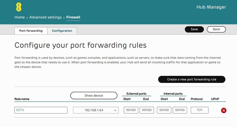

Well @JimM11 , you called it absolutely correctly so thanks ever so much for your help.
I went to my UPnP Samsung TV and got rid of the wifi settings completely from it so it couldn't re-connect, then did a factory reset on the hub to clear out all the port forwarding, then added the CCTV PF rule in and it worked perfectly first time.  I didn't get that funny business with the boxes being highlighted in red either.  See screen capture below.
