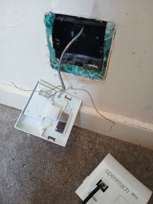

Hello,
I have recently ently moved into a small property and have passed the EE activation date for my property. I am FTTC.
However, I have been having issues with set up and two engineer visits to the cabinet and to make sure I set things up right have not solved anything. Personally, I believe there is a problem with the Master Socket Wiring.
Everywhere I see talking about Master cable wires talks about blue, white orange etc. I have Red, Blue, Green and Brown. I have looked at the back and it is currently set up for Blue in A and Red in B, is this correct?

as for not knowing what comes into the property that’s not entirely true as the A and B on master socket will line up with what is on the other end… because as far as I can remember  it actually makes no difference which way round they go. You can put them on the wrong way round and they will still work as they router works out which is which out of pin 2 and 5, which is send and receive. And if the customer has a small junction box on the windowsill like I do, a hangover from the old GPO 746 days, then you can see what wires come from the pole/ground to the internal wiring as well. If not then the Master Socket is normally on an outside wall and therefore is wired directly.
not sure what all the arguing is about. The answer is no, it is unlikely is it wired up wrong unless you let the cowboys at it. Have Openreach out specifically to test the line is necessary. But it’s more likely that something else is wrong, if anything actually is.
Thank you
I have unscrewed and not touched anything but that is how it is set up.
Four cables. Blue (no white) in A and Red in B. Green and brown just dangling there.
I am in no way an expert and feel I will have to leave this until Friday when openreach come.
This is the only phone socket in house.

@Rooster295 Should be good, just screw it back on the wall plate, your Router RJ11 is also plugged in the correct L/H side socket, so it's all good to go on the Master Socket side. OR will check out if the find the line is inactive or disconnected somewhere. Hope it all goes as planned.👍
