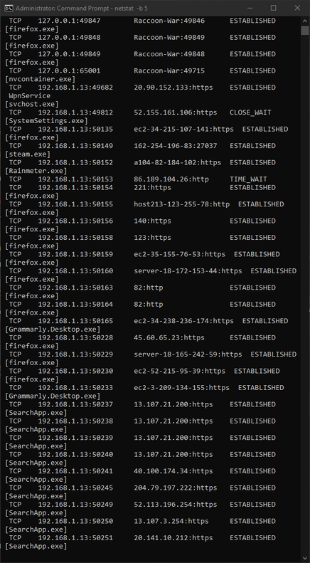

As the OP I would thoroughly check what programs are running on his PC. The command netstat -b 5 might assist.

Thanks for the replies, watching the netstat -b 5 now. Seeing a lot of nvidia and firefox. A couple of somerthings called gwctlsrv.exe and gwidlmon.exe, but they seem to be windows services. A handful of search app.exe which is the windows search iirc? and

Does netstat show the IP 224.168.100.1 as a Foreign Addy?
I'm not seeing 224.168.100.1 on the netstat.
I'm seeing it on the EE tech log: Multicast event client join group:224.168.100.1 client:192.168.1.13 -edit- thinking about it, that's just a group and there are no other ip's grouped apart from my local machine, so probably not the culprit. This is the first time I've come across this sort of thing, so learning as I'm going, hopfully. I may post to reddit as well, as it seems like it may not be an EE thing, but rather something else I need to dig out. Maybe.
This is what the netstat looks like.
Read more
Not sure what this searchapp is or what it's doing, I'm not activly searching for anything and Cortana is turned as off as I could get it without gutting windows 10. I should mention, Raccoon-War is my PC's name, Raccoon-Warren, but windows cut's it short.
