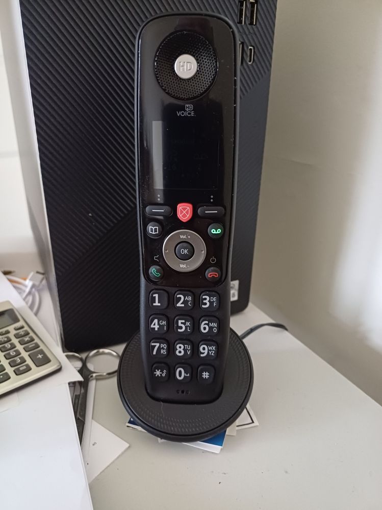

@Richardr66 There is a few with the Essential in the name, and supporting HD, but only two that are pure digital and connect to the EE router without any physical wiring, you may have to do model number, for comparison with @Padcamp if the features are different, or post a photo up of your handset.

The model is X42 F81 with BT on the bottom of the base, this is the handset:

@Richardr66 Apart from a slight cosmetic look to the newer phones, is there any way to find menu / help etc about what version etc of FW that it may be using. That may be the only difference on the phones and how they interact with the router.

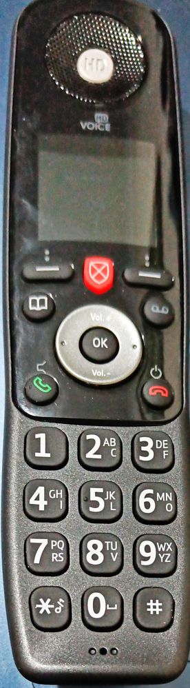

Green LED light showing I have a messageGreen LED light showing I have a messagePick up handset and number of messages is shown below the tape iconPick up handset and number of messages is shown below the tape icon

I have my handsets set up so that I only have the green LED tape icon indicating if there are messages. I could have had both but visual is better as one can see straight away if you have messages without having to pick up the handset.
Go into settings, scroll down to 1571 message alert, press select "Alert tone" appears press left or right on direction button to select on or off then press save for your selection, click on the down section of the direction button and select Message LED, as above choose on or off and the press save for your selection.

As you can see in the pictures I have posted that is the handsets I have.
