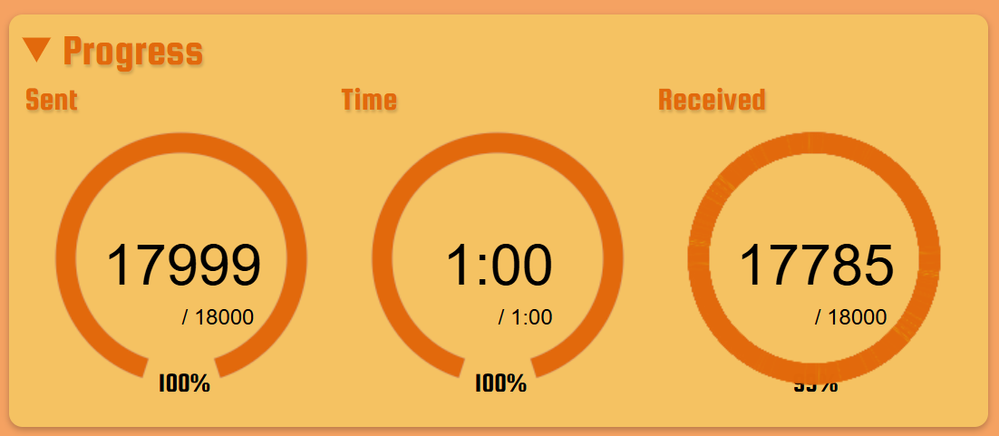

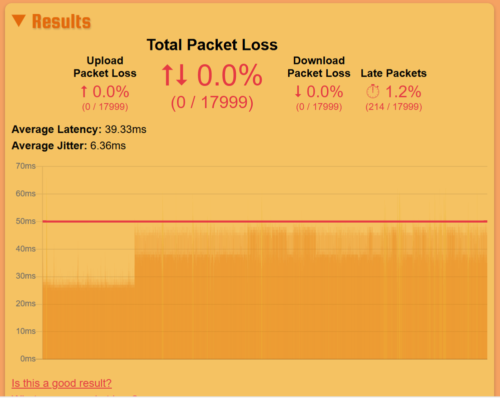

@f00n Your pics are all cleared, you will need to stick a wifi analyser on a device or switch the hub off to see what the EE WiFi is like, until you know what the MAC address is for it i am NOT going to believe that it is NOT YOURS from the hub transmitting.
Netspot by ETWOK.inc will show you with either the Windows or the Android mobile version.
Edit:- If you need to do packet loss test again just stick the Duration up past the preset off 10 seconds to cover your own time period, the function is to rapidly hammer the upload time cycle, ideal is zero loss but delays are important for the feed back.
See The sample pictures when cleared for viewing, 1 minute wireless wifi connected.
