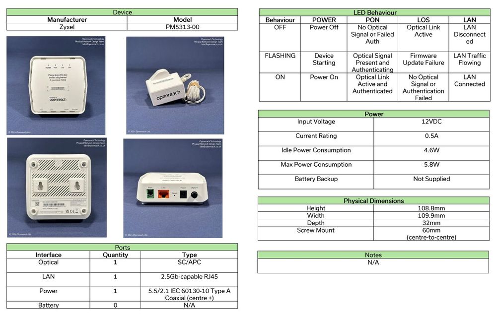

A new overhead fibre line was installed, initially the OTP was a smaller model and that was changed when the engineer called back with the PM5313 model.

not sure if the swapping out of the OTP after the fitters made a call and gave serial numbers would impact this… I do ask the ground fibre guy and he said no.

Zyxel ONT Model Information.Zyxel ONT Model Information.
