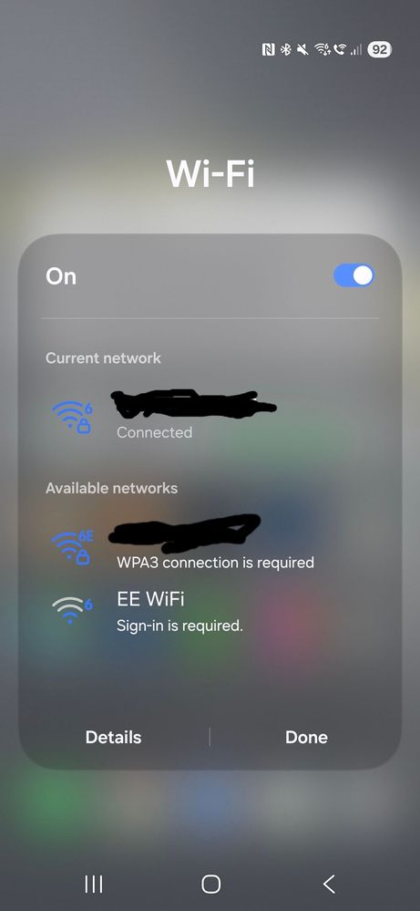

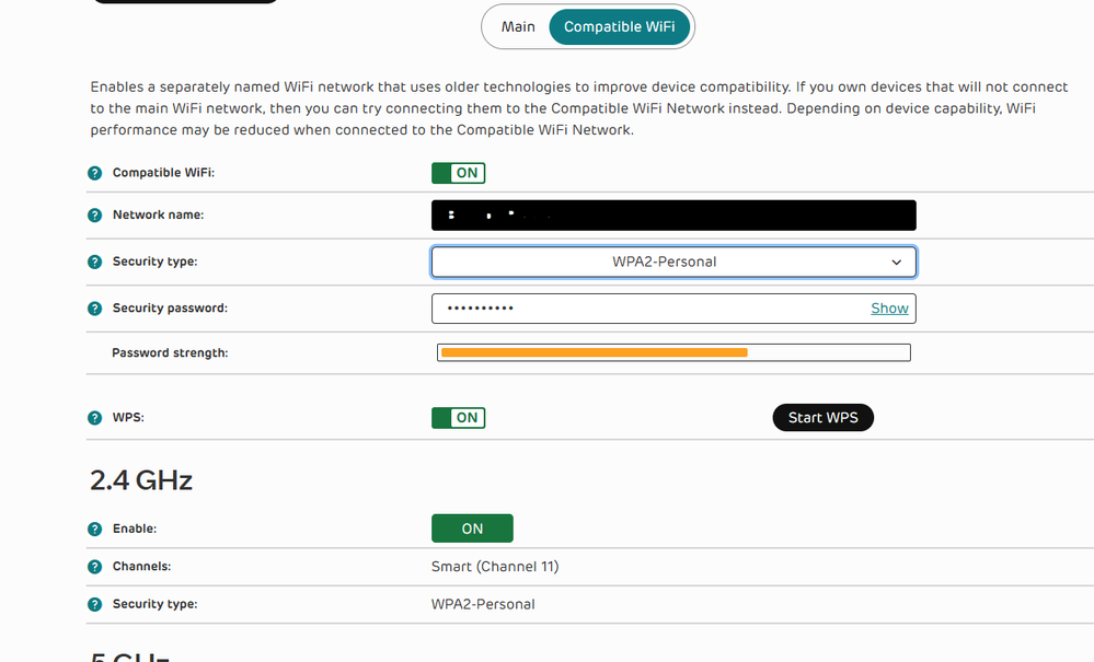

Thanks for the reply and I only wish we could, the only setting I have is for for security type and not Wireless Mode.My old laptop device is seeing no SSIDs Also when I try and connect to the compatible network from my phone it has the little 6 icon which I suspect it should have 5 or blank (see top connection on phone screen), same with the EE Wifi SSID. I think EE have really not got compatible type configured correctly which would be a major flaw and worth a speedy resolution.

There are indeed a lot of possibilities but if EE hadn't hidden most of the options I bet I could get it working fine. They are clearly not setting up a compatible network, what devices was that tested with I wonder.?A room full of old hardware would be a good idea. My current solution is a WiFi dongle for the laptop but it really should not be necessary.

@daveb10780 - Compatible WiFi uses WiFi 6 and that's intentional from what I can gather. DFS channels are irrelevant if you can't connect to the 2.4GHz Compatible WiFi network either.
Given the laptop cannot 'see' the SSID at all then I strongly suspect it's a WiFi 6 thing. I have encountered old Realtek network cards before that have exactly this problem. See here for something that sounds similar.
You may have some success trying to reinstall a different driver package for the network card. A less fuss option (but carries some expense) might be to invest in a cheap USB WiFi adapter.
I have indeed gone for the simple approach of a cheap USB dongle which is certainly the simplest and most reliable solution. It is a little disengenous to market a Compatible Network that is not really. All it does in practice is let you have an old and new SSID since WPA3-Personal-Transition supports most WPA2 devices.
