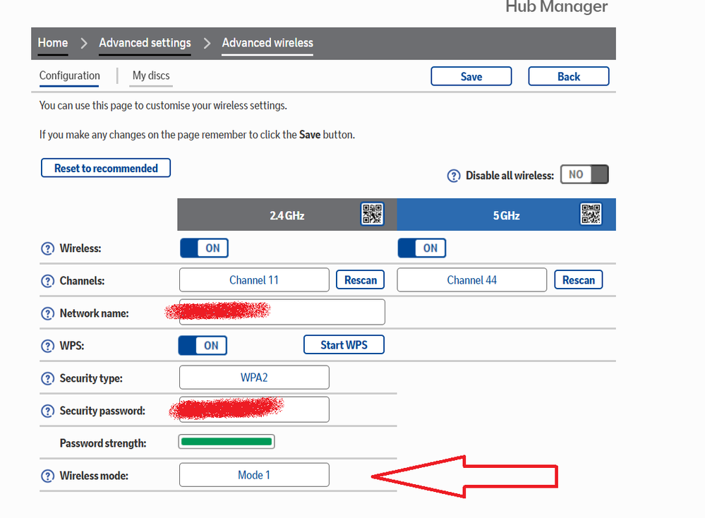

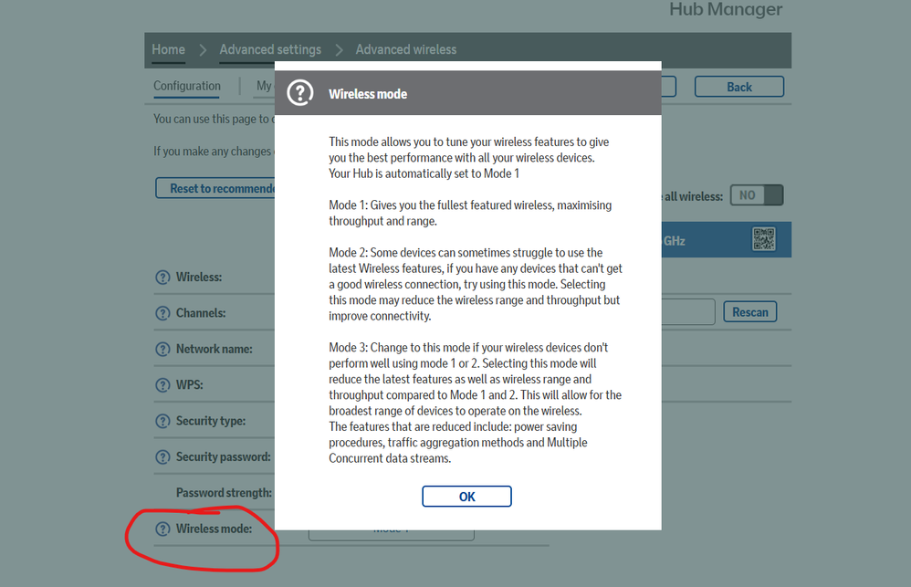

It sounds like you perhaps have a more recent Hub to mine but many have an option on the WiFi settings to change the mode to something more suitable for older equipment. Look for something like this.

@Mooly01 Not on the newer models that is why they have all the extra options, but Auto channel is the only option given and you cannot say where the channel is going to be, along with all the others. main, compatible, guest and the Hidden plus EE WiFi free for all. FW is more clamped options wise on the later EE Hubs. Are you using the BT or the EE version off the old Hub, BT Smarthub2 or the EE Smarthub (2023) model, your FW does look old as the newer wifi report's as smart channels.

@JimM11 I did wonder.
It is an EE Smart Hub SH20A that is not quite 2 years old and it replaced the virtually identical BT version when BT unceremoniously and without asking or telling me moved me to EE at contract renewal time... however...
Fixing the channels was actually one of the first things I did tbh. Let the neighbours channel hop. It sounds like each version takes away user functionality. I think the earlier BT ones also allowed the bands to be separated as well.
FW last updated Dec 2025

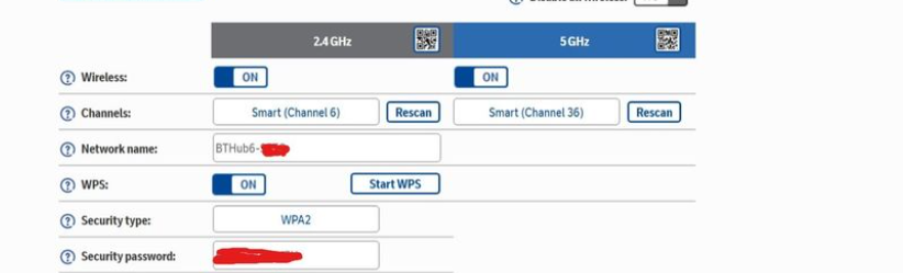

@Mooly01 Linked posting from above did have the BT Smarthub2 FW and was updated to a slightly later version 1st Apr 2025 on the FTTC waiting on OR to install the Fibre connection, so Hub was Factory Reset then to return it ready for connection and to suit the original user's SSID/Password with only a TV connection. Your EE and that BT share the exact same FW versions.
on 29-03-2026 02:24 PM
I'm not quite sure what you are saying with those screen shots vs mine 🙂
Do you mean I will see a different FW version pushed out as I move to from FTTC and over to FTTP?
In your shot here would you not now be able to manually pick a channel if you click on the the box that says Smart (channel 6) for example. Has that option gone with the latest FW you show.

@Mooly01 : The 2 of you are talking about diff routers, not just f/ware.
@JimM11 is referring to a BT SH2.
You have an EE SH (2023). It is a clone of the BT SH2 with similar functionality. You should be able to choose the channels via drop-downs.
