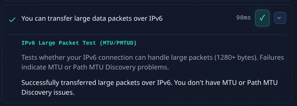

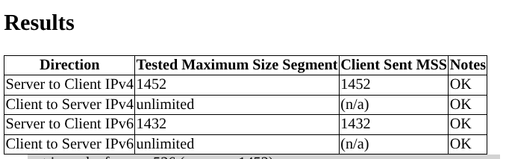

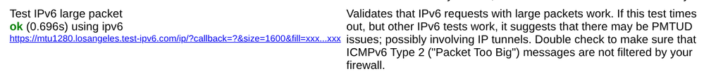

What's piqued my curiosity is the fact that there a a few online tests out there that purport to check for this sort of thing; and when I try running them, they all pass 🤔
From the 'Tests Run' tab > Technical info here: -
From here: -
From here: -
