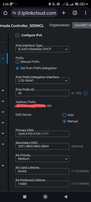

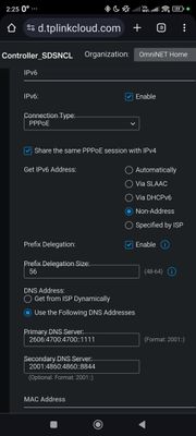

Present settings (don't going to say it's perfect or correct, but it's working) on my TP-Link Omada ER707-M2 router with hardware OC200 controller are:
WAN side:
LAN Side:

Hey @GosforthUK - thanks for sharing - I see you have the same setup I just did for my UDM SE, with a /56 delegated address from EE (WAN) and the internal network at /64 (LAN) upon that public IPv6 address subnet. How do we think of this, is the LAN settings telling us that we are effectively getting a /64 and not a /56 from EE, and potentially we shall change it at the connection (WAN) level, too? Or is that just an hard-coded/configurable setting of our routers that we somehow might have missed? Trying to understand the implications 🙂
On a side note, my config is with DHCPv6 rather than SLAAC as I see in your WAN settings - I see the latter is a manner to tie IPv6 addresses to MAC addresses rather than gateway-assigned addresses, is that helping with more static~ish IPs? On the one hand, a quick look-through surfaced "Stateless address autoconfiguration is a mean for an IPv6 host to assign itself an address based on its hardware MAC without asking a DHCP server. Using SLAAC without privacy extensions (RFC4941) is not recommended." ref. ipv6-test.com while for me the test still returns "No" despite having jus tried to enabled it, aside from that I see no immediate changes, except new dynamic IPv6s assigned across the network upon the change.

Essentially @ErMejoo
/64 is size of SINGLE LAN
and that means, as it's fine, if you planning have only one single LAN inside, and don't bother with more.
Means, if you go via /64 allocation both on WAN and LAN, you will be unable to split easily your local LAN between more than one LAN and all your IPV6 addresses will come in fact under it.
When using /56 allocation on WAN (or even /48 - not sure if BT/EE support this) you have option to use more than one LAN allocation, and have more separation.
/64 it's standard size of one LAN for IPV6 as defined in protocol
/56 contains 256 LANs (so essentially 256x /64)
/48 contains 65 536 LANs and therefore I suspect, it might be intentionally blocked to use by BT/EE (but again, never tested it)
At a present moment, I switched from "no address" which was recommended on BT before, to DHCPv6 on WAN side and it seem to works perfectly fine for me.
Don't forget, in theory, each single IPv6 address assigned it's unique and should be able to be reach over the internet.
Omada routers had before constantly omit this and allow traffic into LAN to be routed (and needed to be treated separately by ALC).
However, my ER707-M2 seems to do routing and firewall both on IPv4 and IPv6 correctly with latest beta FW and my IPv6 LAN devices are not reachable from outside as intended.
While IPv6 has virtually unlimited allocations, this, unlikely from IPv4 coming with more permanent allocations, and essentially you could have fixed IP (of some some sort) like that.
When I moved from "no address" on IPv6 to DHCPv6, my IPv4 immediately changed from typical allocations to something like 31.51.xxx.xxx and don't change ever since yet.
If that has or not connection between each other, or it's just coincidence, not sure.
