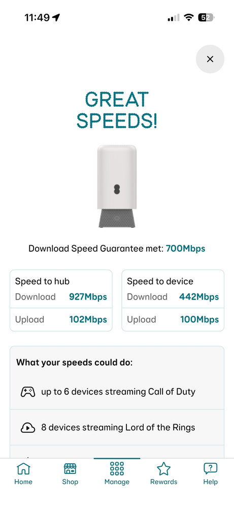

The speedtest on the app is much slower as that's wifi. I have wifi optimiser enabled for streaming as I use wireless for streaming on the Fire Stick in the bedroom. I ran ping optimiser again and it went from 6ms to 3ms. I mostly use the PC via Ethernet so that's my main concern, the wifi has been fine for what I use it for. IMG_1152.png

@mrhuk The app speed test shows you TWO values, the speed to the ROUTER, and the speed to the DEVICES!

That speedtest confirms your BB is running at 927 Meg, well above your 700 Meg guaranteed.
The app is running on a WiFi connected device & would be expected to be lower.
