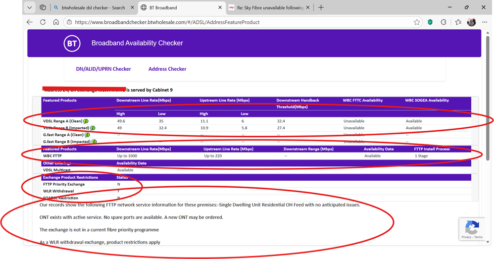

@Spik3y As long as you use the address checker, BT Broadband
and fill the Number and Postcode fields that is generally enough, as long as the exchange has all the needed equipment to patch over to EE then if you can see that more than likely you will get the FF install done. Below mine when cleared for viewing.
All the BTW info, and already have FF installed.All the BTW info, and already have FF installed.

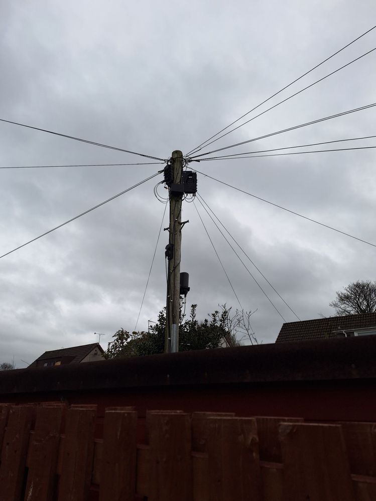

@Spik3y The info you posted, did say that the connection for the fibre was up the pole and you are going to be OH fed more than likely just like you copper connection, if so just take a look, there would be what OR calls a CBT fitted, they use multiple types just depending what the connection is going to be, so my one is an 8 port CBT to feed 8 homes in total just like the copper connection.... Picture is attached once again when cleared for viewing. LHS is OR, RHS is VM Virgin Media.
Top off the pole, larger one is VM Virgin Media, smaller is the CBT with the 3 homes connected.Top off the pole, larger one is VM Virgin Media, smaller is the CBT with the 3 homes connected.
Spik3y
Investigator
Investigator
Just the old connection up the pole on the boundary at the moment, I haven't seen them about since last week.    Theres only 2 cottages here and next door just have a phone at present.
