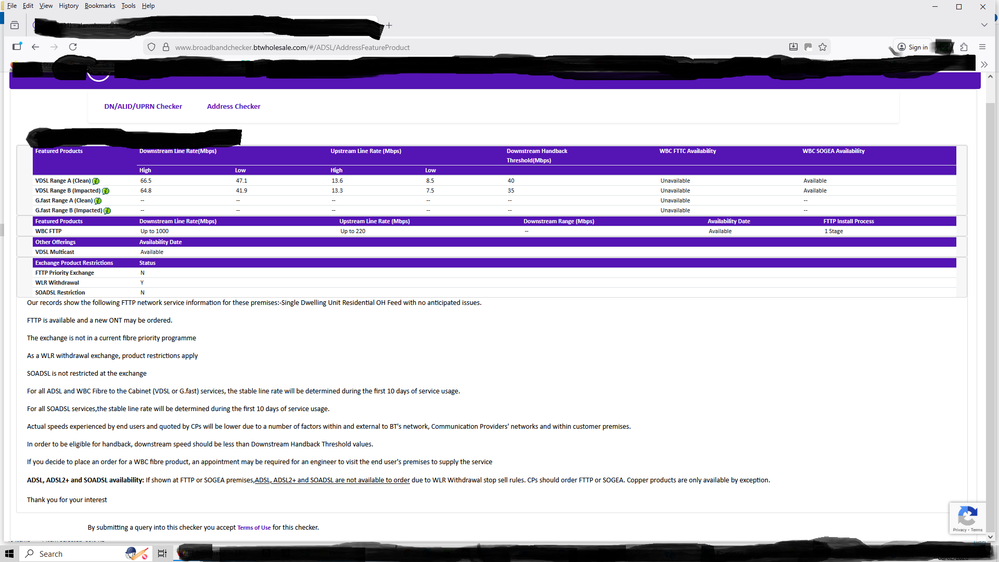

What does BT Wholesale Broadband Availability Checker > Address Checker estimate for your address? Post the whole table, the text below it and the line above it, blanking out your address.

When I enter my telephone number I get
"There is no data available. This may be because it is not a BT line or it is a number which has been moved to an IP Voice service. We advise using the address to check availability instead.
I do have Digital Voice
Using my UPRN results in
"We are sorry but the checker is unavailable at the moment. Please try again later."
The third alternative is Access line Id, which I dont know.

@Gratias You click on the Address Checker box, then the home Number and the Postcode fields are all that is needed....
JimM11 / XRaySpeX
Did not spot the address tab option
This time got
Image upload failed. Try uploading a different image or from some other source.
This was at the bottom of the message, ie a EE community message, not a checker one.

You need to take a Screenshot/Snip of the results to store an image file on your device & then use the Camera icon above your text to upload an image file to here.

When the checker says:
it's just busy.  Try the UPRN again.  In my experience, even immediately trying again works.
@ XraySpeX
This is what you're after?
@ Denzel99
I used the full adress and got a result from that option. Thank you
