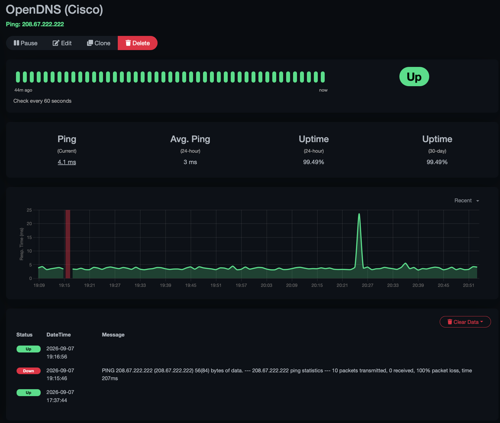

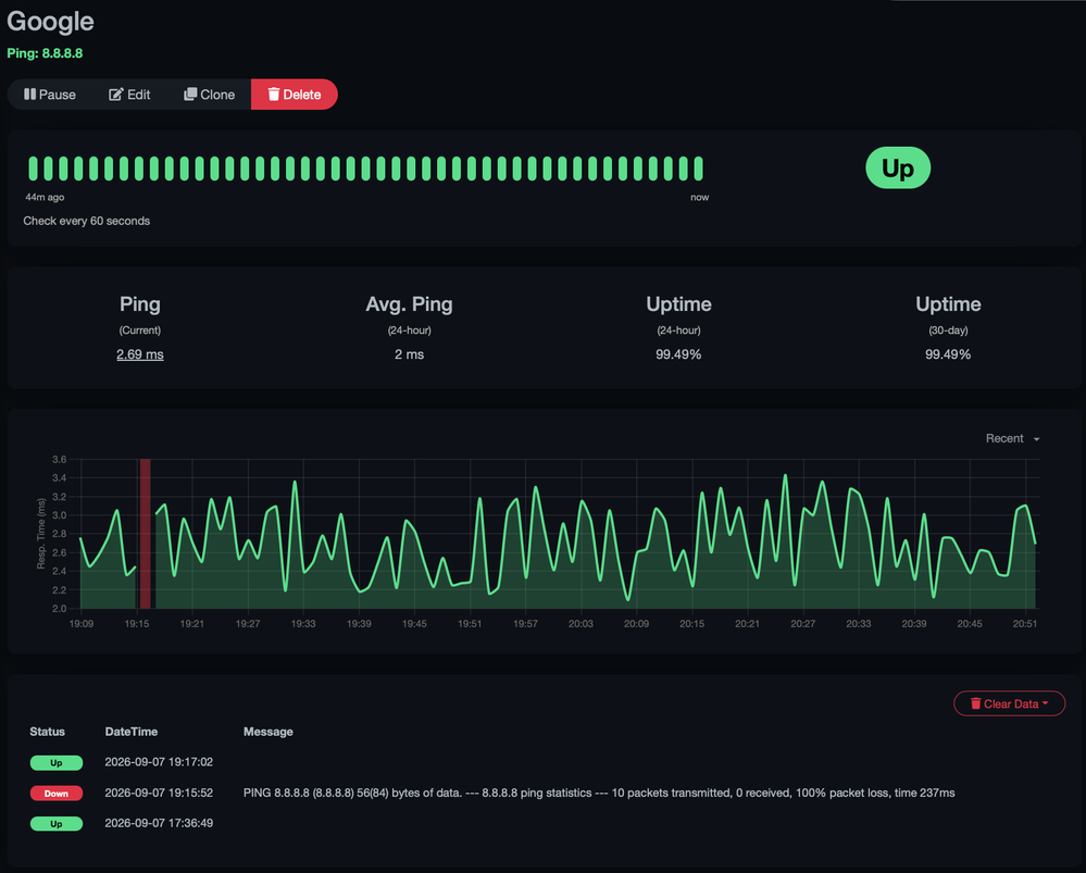

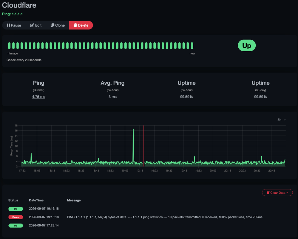

WiFi is solid, just seems to be an issue with the connection dropping then establishing connection quite quickly soon after. I set up a docker container to ping 1.1.1.1 to keep an eye on connectivity after making some changes. Here is a bit more detail on what I have set up.
  • Router Hardware: Upgraded from the standard EE Hub to a GL.iNet Flint 2 router connected directly to the Openreach ONT via Ethernet.
  • WAN Protocol: Configured as PPPoE on the WAN interface.
  • Authentication: Using the standard broadband username [email protected] with BT as the PAP/CHAP password.
  • MTU Size: Overridden and adjusted down from the default 1500 to 1492 to account for PPPoE packet overhead.
  • Link Control Protocol (LCP): Adjusted LCP echo failure threshold to 5 and interval to 30 seconds to handle keep-alives and prevent premature drops.
  • Hardware Acceleration: Enabled hardware acceleration (flow offloading) to support multi-gigabit throughput.
@Prawncocktail Lower your LCP interval down from 30 seconds to 5 and the failure up to 10,
What indication are you getting that the WAN is dropping from the Flint hub? You may find some useful info on your Hubs Forum if you are fighting Wan drops but you do not say so making it hard for anyone else to work out.
https://forum.gl-inet.com/
I'll give that a shot, thanks.
The internet drops out, I can't connect to anything outside my network. I'm not sure how else to describe it tbh.
Here you can see clearly how the connection drops out at 2026-09-07 19:15:46, it then establishes the connection a minute later.

So, 1 discon in 3 hours doesn't make a summer! How frequently is "Frequent" that you are experiencing?
