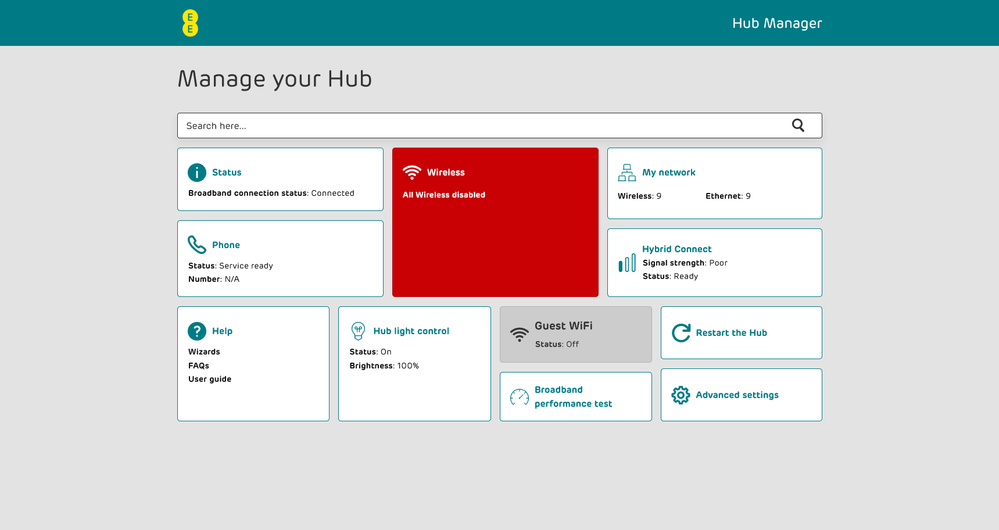

Just went to upload and save my Technical Event Log today (15th July), and came across this new load of old malarkey....
This 'malarkey' definitely wasn't displaying yesterday (14th July) at 1315hrs when I uploaded my Technical Event Log then.
1) This is the 'Home Page', showing 'All Wireless Disabled'. But, quite clearly, this is NOT TRUE!
All Wireless IS enabled, and 'My Network' proves this by showing 9x Wireless plus 9x Ethernet Devices connected:
All Wireless Disabled #1All Wireless Disabled #1

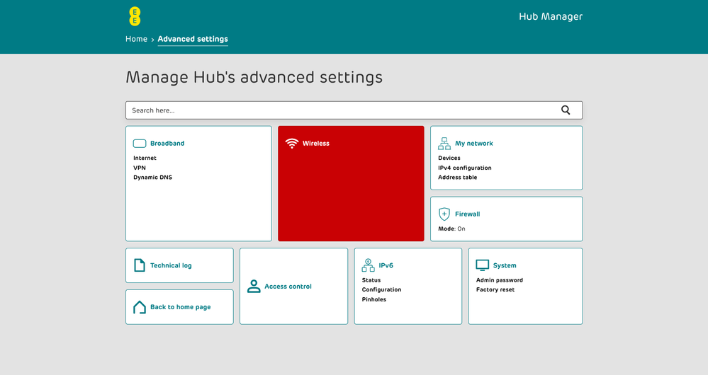

2) This is the 'Advanced Settings' page:
All Wireless Disabled #2All Wireless Disabled #2

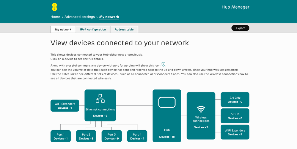

3) This is a more detailed look at my 9x Ethernet Connections, and my 9x Wireless Connections:All Wireless Disabled #3 15Jul26.png

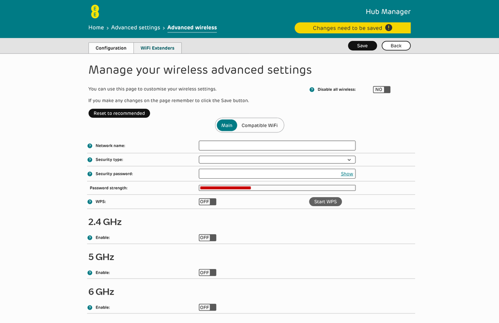

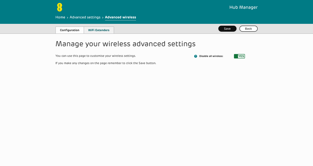

4) This is what I get when opening the 'Big Red Wireless Box' from the Advanced Settings page. I certainly haven't / didn't select 'Disable all wireless' - and yet there it is, er 'Disabled'...
5) When I slide the 'Disable all wireless' switch to 'No', all of a sudden my Network name, Security type, and Security password fields are completely empty.
All Wireless Disabled #5All Wireless Disabled #5
Which is all very weird, as all of my Wired AND Wireless Devices are still connected.
And the Wireless devices are connected to my customised Network Name (aka my SSID), using my Security password.
No, the Hub has not been updated and/or powered down since 16th June, as the Technical Event Logs show.
No, the 'App' has not been updated for a few days.
No, I'm not going to Power-Cycle the SH31B (32), or re-enter my SSID credentials - unless I absolutely have to e.g. the entire system locks-up. I'd like to see if this phenomena disappears as quickly / mysteriously as it appeared - and / or if it's going to get worse....
Sadly, yet more flakery bubbles to the surface, regarding this latest Firmware.   🙄
@Gelert5 DO NOT RULE out the App having a play with it all, and little strange the 3rd picture showing all your Ethernet connections does not tally with the first two totals as well, EE definitely keeping you on the toes with it all! wonder why the 6Ghz is also showing on a SH31B hub? is that an addition now or have you noticed since the upgrade to the FW....
Until the save is applied, and the warning possible explaining network may be dropped for settings to be applied who knows what is going on or going to happen point in time....
Also shows all off your wireless wifi devices are on the Extender only, is that a true correct way nothing on the EE 6+ wireless wifi for the Hub?
Nope the SH31B is still a two band only unless they are pulling your chain...
@James_B You may won't to take a look see at this!
Now has the GUI look and feel off a wifi 7 Pro puppy...
Compare EE Smart Hubs | Device Help | EE
@Gelert5 You may want to grab and capture the following also, bit off a pain to do and you may need a few screen captures to get it all, but Advanced Settings - My Network - Address Tables, see were everything wired/wireless is getting assigned assuming the hub does not throw it's hands up in the air doing so....
Think i managed to get up near the 80day's capturing the logs, slow down got to about the 10second page swap delay, then a FW update crept in and wiped the Hub clean, so i just gave up on it all....
Need to get you on the FW testing program shake it all down as you do have all the parameters needed, Hub Extender and Backup all in the one nicely wrapped bubble....

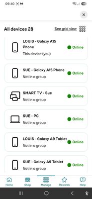

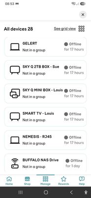

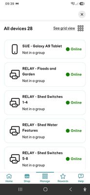

@JimM11  Well, certainly the EE 'App' is having its own meltdown - LOL
I took some screenshots of the App pages, the day after I posted those five pictures of my Hub pages.
The 'Offline' devices are my WIRED devices, and the 'Online' devices are my WIRELESS devices.
Which is bonkers...
The Wired devices were (and still are!) all very much Online, and haven't been Offline since 16th June.
App Screenshots #1 16Jul26.jpg          App Screenshots #2 16Jul26.jpg          App Screenshots #3 16Jul26.jpg
And as I type this some 4-5 days later, all of my Wired AND Wireless Devices are still connected - but not according to either the SH31B (32) Hub OR the EE App.
The Hub is still 'reporting' that I have no Wireless connectivity, and the App is still 'reporting' that I have no Wired connectivity.
What a state of affairs... 🙄
