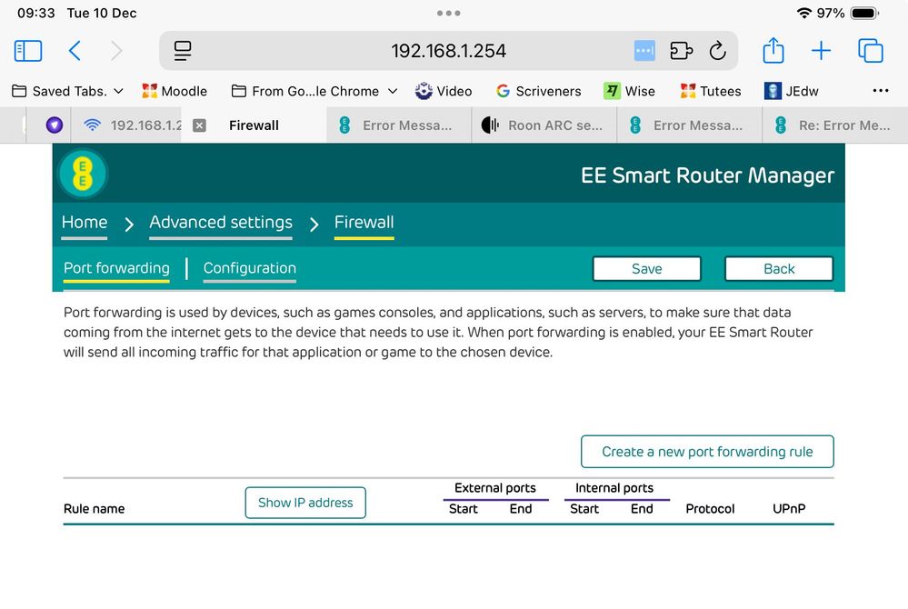

i've gone into the hub to find the port forwarding rules and that page is blank (see below). Any advice, much appreciated. I realise this is helping a complete stranger and I'm grateful. Alan.
So you haven't Port Forwarded port 55002. You need to Create a new Port Forwarding rule.
Excellent. Thank you. Where it says 'External ports' and 'Internal ports', do I put 55002 in all four boxes? I did try that a few days ago but the rule would not save. Do you have any suggestions? Many thanks. Alan.
