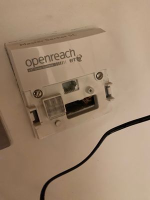

Locate the hidden test socket that is revealed when you remove the bottom half of the split faceplate (2 screws or press tabs) of your master socket. Only do this if you have a split faceplate. Do you have any extension sockets in the home even if unused? Are there any wires connected to back of faceplate of master socket?

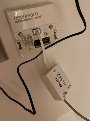

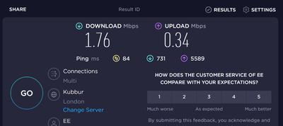

Thanks a lot for the prompt response. I did use the test socket as well (see pictures attached). The results are now even below the 3Mbps but it was like that even before I use the test socket in some instances. The router I don't know how to check if it's resyncing a lot (the internet and wifi symbols are green but blinking real fast  but I think thats normal). Also tried with ethernet but not improvement on download speed.
Here are the results from the test socket.

What about the QLT? That is important. Also:
You'll see the BB light go red when the router re-syncs. It's done that twice in the last 2h40m, which is too much but 2h40m is not really a sufficient sample..
The speed that matters is the sync speed, about 5 Meg, reported by the router. The lower wireless speeds are variable due to your local conditions & you should get faster over Ethernet.
Leave it alone plugged into test socket for at least 7 days & don't reset or resync the router yourself. Then post the full router stats & System Uptime. If you must do speedtests do them wired.

@Soti399645 wrote:
I get that EE has a minimum guaranteed speed of 3Mbps but that's not inside the range they provided and ... if the minimum guaranteed speed is the average speed.
The Min. Guaranteed Speed is not meant to be an average speed & it is always below the estimated range, being the max. sync speed that EE will guarantee to investigate your speed issues & let you go if they can't. You cannot appeal to that Guarantee as your sync speed of 5 Meg consistently is above the Guarantee of 3 Meg.
