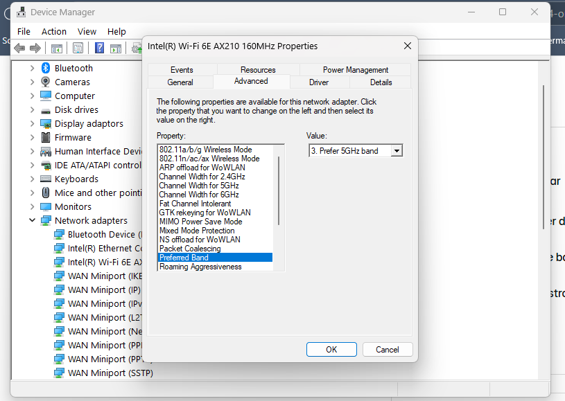

My pc, keeps switching from 5ghz to the 24.ghz after a few minutes. I have set the wifi adapter to prefer the 5ghz as people have mentioned but it keeps doing it. Never had this issue with my BT router.
In the setting for the wifi no where can i see to tell it to keep this device on 5ghz. Anyone got any ideas?

@gjdemon6646 What specifically are you changing property wise for you wireless nic card, there is really nothing you can do router to help, so it is all down to the PC nic to sort it out. Assume you have went looked at any driver for the device and also trolled the NIC side for help regarding the issue. As @Mustrum points out, you can always put the old gear back.

Yes i have the latest drivers, first thing i tried. I also reset the pc fresh in case any conflicts.
@gjdemon6646 Once the picture is cleared for viewing will take a look see.

@gjdemon6646 So take it the NIC in the PC is also wi-fi 6 compatible, 5ghz is 5ghz no matter what. You may wish to look and post type/detail/driver for the wi-fi NIC that you have installed. The forum is not a service support but we do try to aide if possible.
@gjdemon6646   I have approved the pic now.

@gjdemon6646 Also try the roaming aggressiveness down in value to see if it helps keep you on the 5ghz band.
