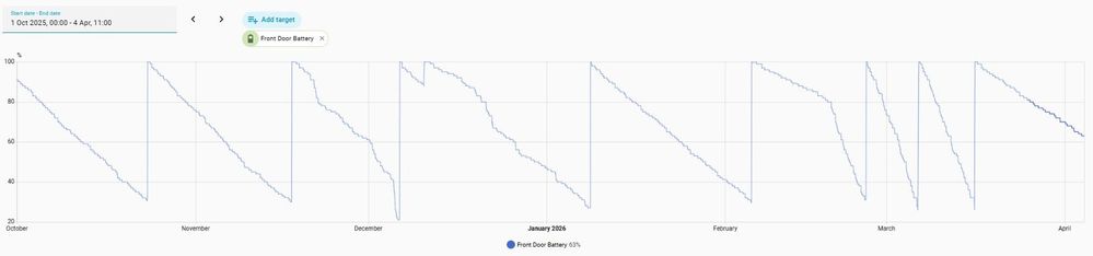

I noticed that whenever I was using compatible mode with battery powered devices the batteries ran out quicker than when using other WiFi access points. I really noticed this with the Ring doorbell when I changed its WiFi from my old BT Hub to the Router Pro WiFi7 Compatible Mode in mid February and the battery life halved. When I switched to the TP link access point in March the battery life extended again. I captured this in the graph below. The signal strength was just under -60dbm in both cases.

Where do you get that graph? Is it part of the Ring app? I don't see it.

@XRaySpeX - looks like Home Assistant.
