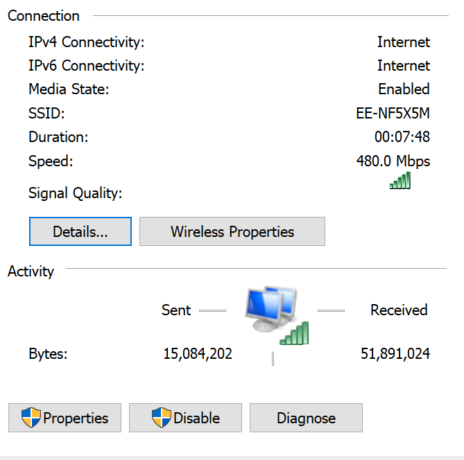

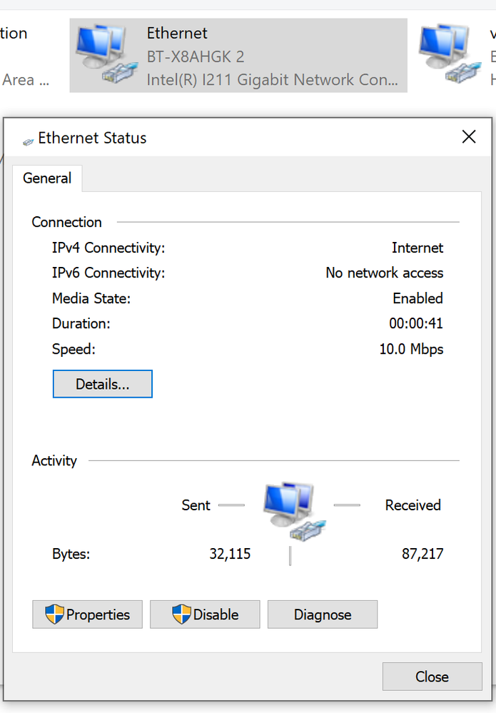

Hi XraySpeX, thanks for the reply. On my Network Connections page I'm getting Wifi of 7 & 480 mpbs. On ethernet connection it's stuck on 10mpbs ( on the first couple of days when i connected the new router 1 was getting 930mpbs on ethernet) Also no service on phone line still. Don't understand why the ethernet connection is still showing the old BT router.
 This roughly roughly started the same day i got my last bill from Bt. I'm wondering if they have hit a switch to disconnect me from their service but it hasn't been applied to EE correctly. wifi.PNGethernet.PNG

@Rickster7  The connection from your WAN port to the ONT is showing a 1Gb connection which is as expected.
However the one on your LAN port only shows a 10Mb connection, so either that device can only cope with that speed, or the cable is not Cat5c or above or is faulty.

The connection on the lan port is the same device that was being used when i was with BT only about 3 - 4 weeks ago and is the same as when i installed the new hubm the speed was fine for the first couple of weeks, but within the last week on the day i got my last BT BILL, it just started showing 10mb. I have a new CAT6 cable coming tomorrow, so i'll try that and see if works.

@Rickster7 It is a very old Ethernet controller, but certainly capable of gigabit speeds, you have not changed any of the properties for the nic or anything like that, should set itself as 1000/1000 with the EE router lan port.
