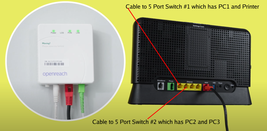

All Ethernet cables are Cat 5e or higher (multiple cables tested and verified).
Regular Wired Setup:
  Fibre ONT → EE Router (WAN port)
    EE Router Port #1 → 5-Port TP-Link Switch #1
      Switch Port #1 → PC 1
      Switch Port #2 →Printer
    EE Router Port #2 → 5-Port TP-Link Switch #2
      Switch Port #1 → PC 2
      Switch Port #2 → PC 3
After Open Reach Engineer Wired Setup:
    EE Router Port #1 → PC 1
    EE Router Port #2 → PC 2
    EE Router Port #3 → PC 3

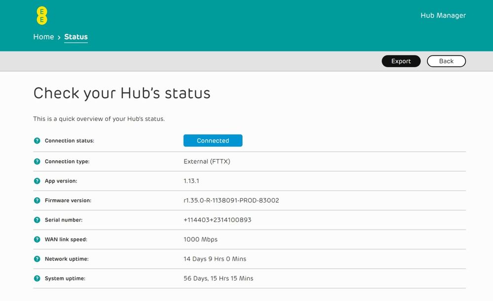

@Ann-C If you get a chance if/when you get the issue, but also before web manager to the hub http://192.168.1.254 take a look at i think you will see it in the Status page, Marked as Wan link speed, you should see this as per the picture.
Wan link speed, if  wrong may show 100 MbpsWan link speed, if wrong may show 100 Mbps
