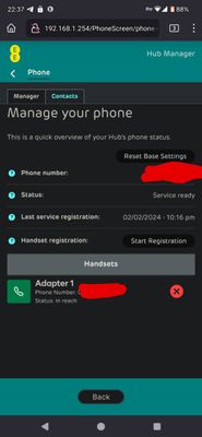

Just realised you’ve added an image but it hasn’t been approved yet.

@liamgc1993  I see that you are using the EE app. With BT you access the router direct by entering 192.168.1.254 into a browser
I was not using the EE app, you can see in my screenshot I was accessing the EE router's firmware menus via IP address 192.168.1.254

I thought it was the app as it is a different layout to the BT hubs settings. If that is all the phone settings then it doesn’t appear that you can select 2 or 1 lines. Have you tried phoning EE?

You can only change MultiCall (1 line or 2) through the Settings on DV handsets. It wasn't a problem initially as BT used to provide one or two free handsets but I believe that they don't do that anymore. It can't be done through the Hub Manager, certainly not on a BT SH2, so your only option is to try contacting EE and see if they're able to change it. Alternatively, buy a DV handset.
