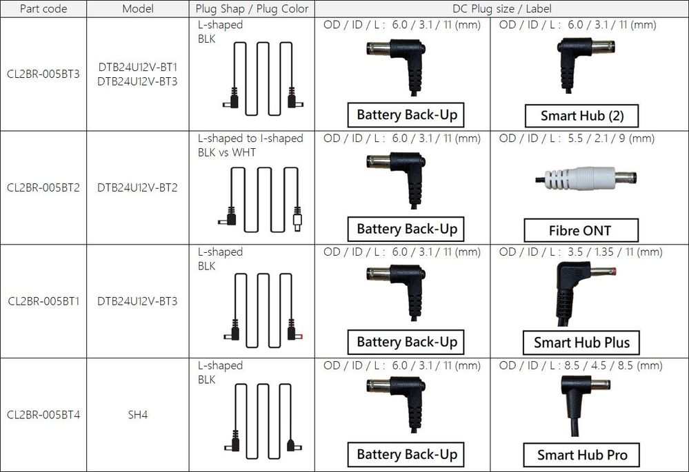

I've had a reply back from CyberPower's own support.  People may find this useful:
