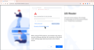

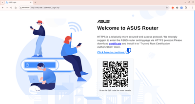

Of relevance: came across this the other day after updating the firmware on my Asus Router to the latest version: -
@bobpullen The Asus is now HTTPS and Trusted security cert!
bobpullen
Star Contributor
Star Contributor
@JimM11 - not sure what you mean? The screenshots above are from an Asus firmware that was released 08/08/2025 and they describe that accessing the hub via IP will return an untrusted warning (same 'issue' @Brian160 is referring to with his EE hub).
The screenshots advise that the hub's certificate can be downloaded/imported to the local machine's trusted store i.e. exactly the suggestion I offered @Brian160 for his EE hub.
Point I was making though, is that there are other hubs out there that are encouraging HTTPS connections for local admin, and they too present browser warnings.
@bobpullen Asus is now 100% https since the latest FW, you can no longer get to the router by http at all!
