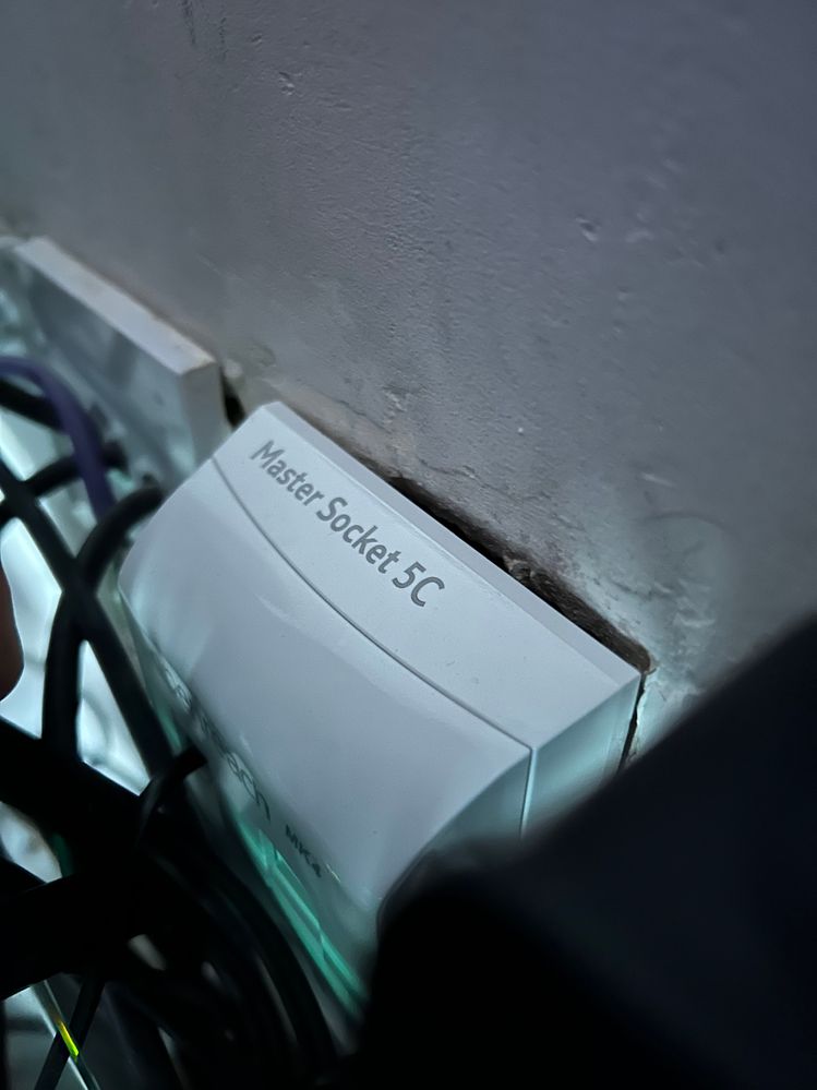

@JonT69 ? it is an OR master socket that you are plugged into, and that you are using the standard RJ11 cable that was supplied, not a long cable to get the router elsewhere, and that you also DO NOT have any OR/BT extension socket's dotted about your home even though you have NO Landline currently. Post up a picture of you Master socket connection when you are back later.

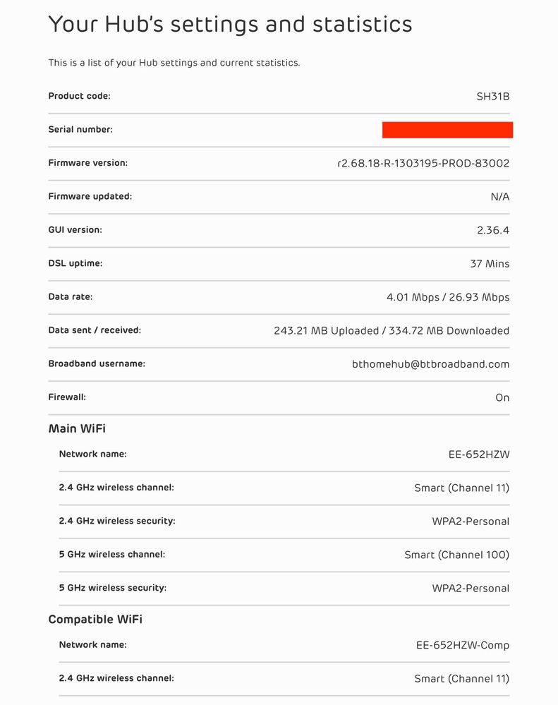

Here are the router stats requested by Xray.....

IMG_0883.jpegGoes

Goes straight into the back of the EE router.
We have no telephone sockets or circuits live in the house or connected.
XRaySpeX
EE Community Star
EE Community Star
Thanks. Locate the hidden test socket that is revealed when you remove the bottom half of the split faceplate (2 screws or press tabs) of your master socket. Only do this if you have a split faceplate. Do you have any extension sockets in the home even if unused? Are there any wires connected to back of faceplate of master socket?
Reboot the router & plug it into the test socket using a DSL dangly micro-filter. Post the full router stats & System Uptime when plugged into test socket.
Is the issue any better?
An aside: Do you possess any other suitable for FTTC routers? The EE SH+ is awful for reporting proper FTTC stats.
