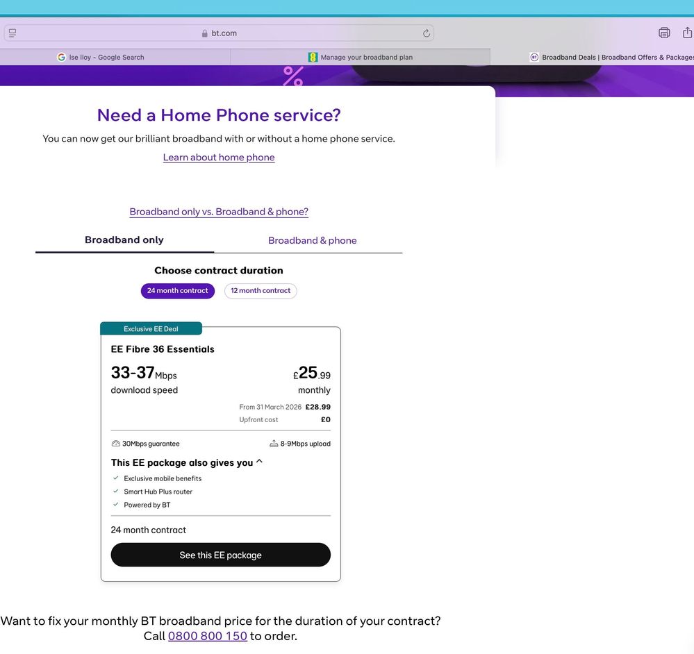

I'm being offered speeds of 37 mb plus and FTTC by BT Openreach but whilst some of their systems say we are good for FTTC others say we are not. I believe it's some sort of Openreach issue but EE refuse to involve them or an engineer. You can see the different systems saying different things below.

11-03-2025 02:32 PM
Thanks for taking the trouble to respond.
Definitely no FTTC in 2017. We built the house and were waiting for fibre so I was on the list to be informed and sought to upgrade when it became available but with no changes to speed.
Wired / ethernet speeds today are 25.9 mbps download and 3.52 upload. Anything above 34mb would be fantastic .. I'm not greedy ... just want to be able to enjoy UHD etc on AV and for me to use Teams for work without hacking my colleagues off.
Did you notice that the BT Openreach extract below says that FTTC is unavailable (ringed in red?), contradicting all the other communications? That is where I think the issue is...

11-03-2025 02:56 PM - edited 11-03-2025 03:01 PM
You said in your OP:
@JonT69 wrote:
In 2017 I was enjoying speeds of 35mb with BT.
It is impossible to get 35 Meg w/out having FTTC. The fastest you can get w/out it is up to 24 Meg ADSL. So something doesn't make sense to me in your description of your circumstances.
The image you just posted is not a BT Openreach extract but it is a BT Wholesale Availability Checker which is the 1 that governs what ISP can sell, not OR. On that you should be looking at the WBC SoGEA Availability column which is all that ISPs are now able to offer you.

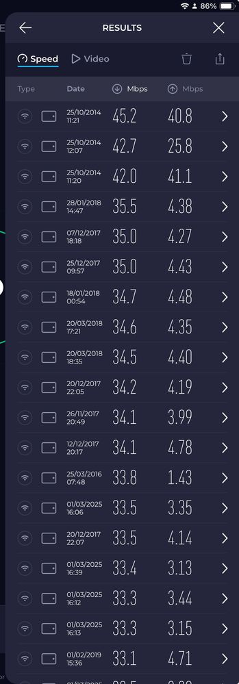

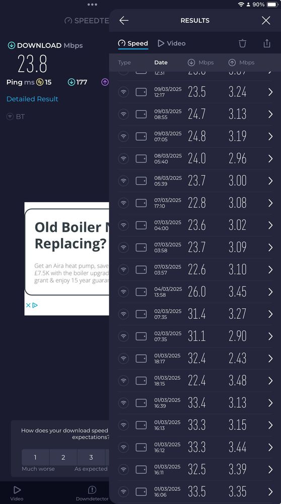

11-03-2025 03:44 PM
Ok so when our house was built in 2002 they brought a separate line down which I recall gave me better speeds.. I'm not an expert in this field so have no idea about WBC SoGEA etc, just a mug who pays £45 a month for a 25mb speed!
Short and long is that I was getting speeds of mid thirties 8 to 10 years ago and having upgraded I am now down to 24. Here's the speed tests from over the years.
Any ideas? Really appreciate your help here. BTW its not an internal thing as all checked out multiple times ....the EE Router plugs straight into the phone socket and we have no landline.What was weird was when the new router came 10 days ago we were enjoying speeds of mid thirties which enabled everything to work but since then they have dropped right back
Historic highest speeds
Fall off since new EE Router temporarily boosted the speed

11-03-2025 04:00 PM - edited 11-03-2025 04:07 PM
Anything with a Up speed above 1.3 Meg is FTTC. So you've never been off FTTC. Any reduction in Down speed will not be due to the type of BB you have but to other factors.
It is interesting that in 2021 your speed dropped from 35 Meg to about 24 Meg & a similar thing is happening now. So the same factors must be in play.
Let's now concentrate on the here & now. Please address my points 1. & 2. in my 1st reply.

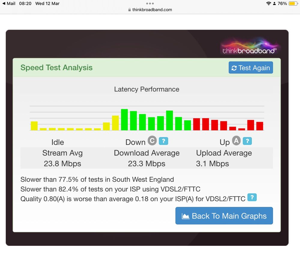

12-03-2025 11:10 AM
Here’s the link to the test. Thank you again.
https://www.thinkbroadband.com/speedtest/1741777626726633855
EE engineer has been today and found an exposed wire in the BT Openreach socket which has been replaced. This test is post his work.
J

12-03-2025 12:53 PM
Thanks for sharing those results for us @JonT69.
I'm glad to hear that you've managed to get an engineer on the case with this, even if it doesn't appear to have immediately fixed the issues.
Are you using WiFi or a wired connection when you're getting these speeds?
If it's WiFi, have you tried changing the wireless channel via your hub manager, or using a different frequency?
You can find all the details you need on how to do this via our help article here 😊
Peter
