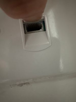

So I’ve just moved into a new build property and the modem is installed in a downstairs cupboard… which means the router is now also in said cupboard. Problem I have with this is the house has three floors so the further up you go the less speed you go and the majority of our time is spent on 2nd and 3rd floors. There is an ADSL connection next to the modem and one in our living room in the 2nd floor but obviously the cable provided doesn’t fit into this. I was hoping I could plug the modem into the one on the cupboard and then the router into the one in the living room. Is this possible?

@Frinjikagawa Take it you slid the cover up on the single socket and took a look at what the connection behind it was, just in case it is an RJ45 for Ethernet and not a standard phone connection?
I didn’t but looking at it now a Ethernet wouldn’t fit into it. I didn’t realise full fibre was different as last time I seen one of these sockets I plugged my old Vodafone router into it!
That's an ordinary BT phone socket. Not suitable to run Ethernet for Full Fibre. I presume the one in the living room is a master socket, possibly with 2 ports.

@Frinjikagawa How old is your new build, some off the newer are completely wired, my sister's is but it is only 2 years old.
Once your picture is cleared will take a look, the sockets if they are interconnected you may be lucky and an Ethernet cable was used between the connection's but will take someone who knows what they are doing to have a look for you.
If not then you are going to have to use the location or get a cable run to where you need it!
Edit:- you need to run a cable or get someone to take a look what the cable is behind that BT styled socket!

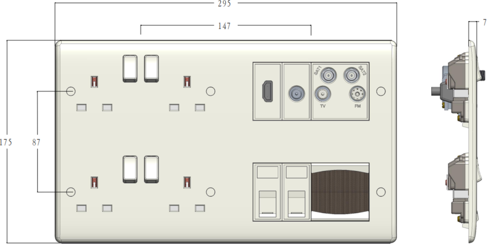

A lot of new builds now have multimedia panels in the main rooms like the picture below which have access to ethernet connections but failing that you will either need to run your own cabling (lot of faff), use power line extenders or Wi Fi extender/mesh hubs.  To be honest, I use a combo - powerline extender to the garage which is 150 metres away from the house which feeds my Ring Spotlight Cam and EV charger which is enough and Wi-Fi extender hubs but wouldn't recommend the EE one SW40J (see my other post - hit and miss when it wants to work but brilliant when it does)
