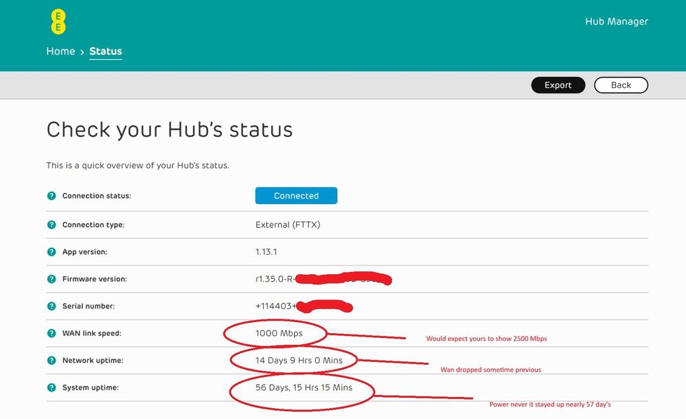

@SirGar You need to web manager to the Pro hub https://192.168.1.254 before ANY power is removed or ANY reset to the hub is done, in the Advanced section the logs are there and you can print those to a PDF file or just look at them to see if at a particular time something happened..... If you find that the time no longer goes back your hub has completely reset....
There are two parameters you need to look at, System uptime and Network uptime, that shows ie Power has never been lost, and the other shows oops the network dropped and reset the wan connection.
The cable would have to loose all connections for both individual pairs that could happen but unlikely, you would see the hub fold back to 100Mb/s speed, or even worse zero speed, but you may be finding that the 2.5Gb/s Wan connection to the ONT if you are up there speed at 1.6Gb/s package then either ONT/Hub may just not be working out with each other, possibly folding back. Real pity that the FW updated so quickly and now the suckers are all up there, so no way back unless EE CS can do that for you?
Capture your logs, and also your advanced status screens that is the proof you need.
It may also be a good idea to see how sticky your wan iPv4/6 is, www.whatismyipaddress.com will show you that and you can also capture the values or write them down.
It's an old picture from 18 Months ago on a 6+ hub but will give you the idea what to look at once approved for you to see.
Old picture but general idea....Old picture but general idea....

@JimM11 wrote:
There are two parameters you need to look at, Complete uptime and Network uptime, that shows ie Power has never been lost, and the other shows oops the network dropped and reset the wan connection...
This is a good suggestion. We know the LED is flashing orange but what we don't know is if the hub is restarting, or it's just the WAN connection being lost.
As per quote, there's a 'Status' section in the Hub Manager that will present two values: -
Network uptime: this is the time since the last successful Internet connection attempt
System uptime: this is the time since the hub last restarted
If the second is substantially bigger than the first then the hub isn't restarting; if they're broadly aligned then it is.
