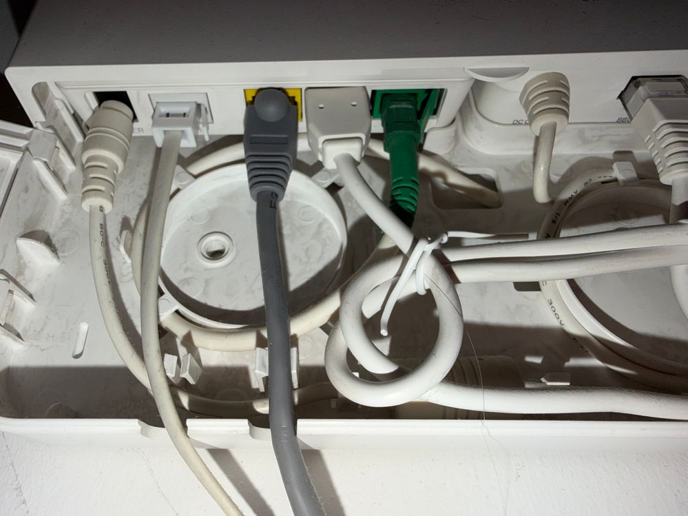

Jim I managed to open the ONT and took a photo
Presume as I can see a yellow RJ45 connector we have the older 1GB ONT
@LisaN_88 You sure have and an old one at that with battery backup unit etc, so you are going to have problems with it as well, model is no longer supported by OR, so would expect a complete changeout off the whole unit. Think you will be the first one shown on the link below.
What do the lights on the Openreach modem mean? | BT Help
Is your landline phone service also delivered via that ONT, do see you have it cabled 2nd connection left right next to the Ethernet cable? If you need also handy video.
BT Openreach Fibre ONT - How to replace Battery Backup Batteries for phone line
