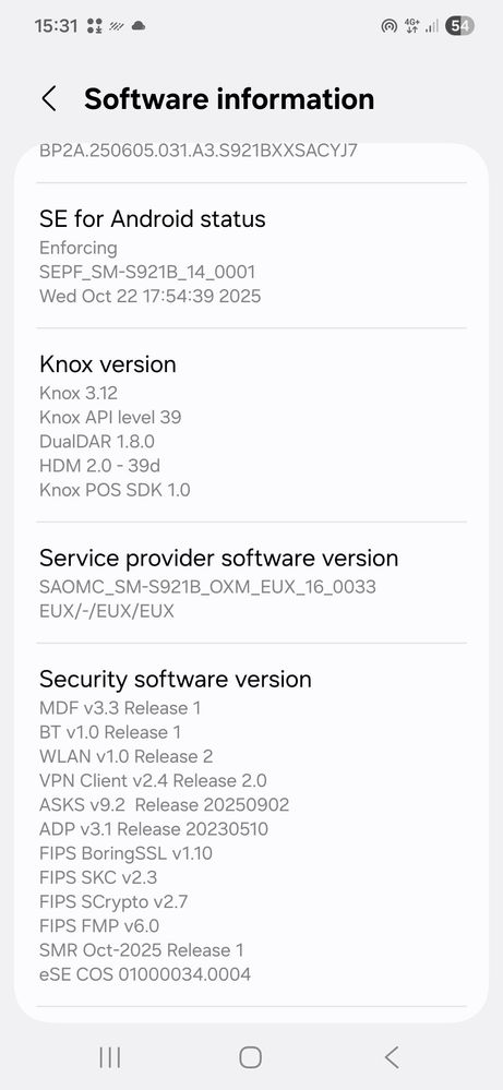

I assume this is the section your referring too

Ah, yours is running EU-generic firmware - the EUX.
It "shouldn't" be a cause, but I've experienced similar performance issues on a previous phone that turned out to be directly related to the BTU firmware so that's something only ruled out by EVR firmware being installed. That's something only Samsung or an EE repair centre should undertake.
Might be worth comparing with your work phone, which variant it runs.
