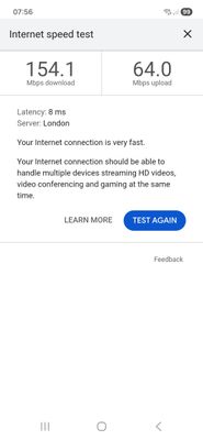

Sorry not resolved after all. Still happening. Internet speed test next to box was download speed of 122mb which surely should be sufficient.
Just did speed test next to router which was 154mb. Thought it was minimum 400mb so something is not right here.
I've just tested the download speed from your hub and it's showing 522 Mbps, so the connection is fine.
Looking at the stats on your TV Box today, it's reporting that the signal strength is the same but that the wifi noise level has decreased quite a lot.  So it's better than before, but still borderline strong enough.  Is there anything you could do temporarily, just to prove it works with stronger wifi?
