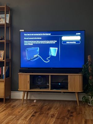

Hi We have a new pro box that looses the internet connection after going into standby. After using the remote control to bring the pro box back on it complains that there is no internet connection. The pro box is connected via the supplied Ethernet cable. No apps or tv channels are listed. We’ve reset the router and the pro box but the only way to establish the internet connection is to remove/ reconnect the the Ethernet cable at either the hub or pro box.

When this happens, can you please check the Broadband settings screen in the TV Box settings - what does it show the network status as?

If I go into Broadband to review the settings all I see is a message “Your box is not connected to the internet” If I follow the help connecting option the pro box tries to reset the connection to the router 2 or 3 times but fails. Pulling / reconnecting the Ethernet cable from either the router or pro box enables the pro box to connect.
