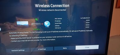

My Samsung smart tv was connected to my EE broadband . Haven't used tv for couple weeks turned on last night said not connected so went through connection wireless put in password got pic underneath. So put in manually all data found on Google as nothing on my EE app to help and dont have computer, still won't connect. Reset tv to startup still won't connect rebooted rougher still won't connect. Now also have all these other listed wireless connections including my printer. Last attempt WPS still says wireless network disconnected any ideas ??? Plz Thanks in Advance

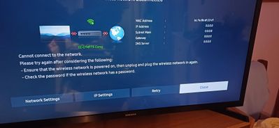

Nope still get

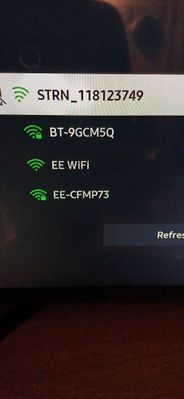

Show us the list of WiFi networks the TV sees.

And non of them will delete the EE.      73 only one I want
Your 2nd pix which you said won't connect to my suggested Compatible WiFi isn't even trying! It's trying to connect to EE-CFMP73 when you should be trying EE-CFMP73-Comp.

EE- CFMP73 Is my router it's always connected to that will try comp but think I did try that yesterday with the password of router but that password goes with the 73.

Nope and the ip add, subnet m, gateway, dns all still at 0.
