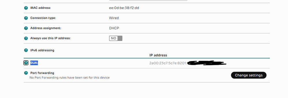

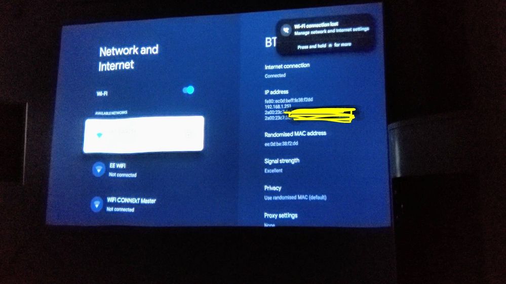

I have a wierd problem with my Chromecast HD connecting to an EE router via an EE extender. The Chromecast keeps giving a notification that it's lost its internet connection when it hasn't (the Chromecast very briefly says 'No Internet' in the status area then the notfication pops up). This message pops up every couple of minutes or so and ruins anything I'm watching but mainky in YouTube. Google doesn't want to know saying it's an EE problem as it doesn't happen when I connect via my phone's mobile hotspot (connected to the same wifi) or if I turn the extender off and connect to the main router (very poor signal as oppsoed to excellent with the extender on). When I look at the device in the router Hub Manager My Network, the device has hundreds of IpV6 GUAs which doesn't happen with other devices....see pics. Anyone come across and resolved this?
As a test, I plugged the chromecast HD into my PC monitor so it connects directly to the router and this issue does not replicate. There are no mulitple GUAs as in the pic above....I know the extender it usually connects to may have a lot iof things connected (home automation stuff) but this setup (with no additional devices) has worked for two years. This issue only being a recent thing.

As I say the streaming doesn't stop on the Chromecast HD it just keeps telling me its lost the internet connection every 4-5 mins...it's disrupting my enjoyment  lol.

Not sure if this has any relevance....I don't seem to be able to turn IPv6 off on the router....is SLAAC the same as Stateless...?
https://www.reddit.com/r/Chromecast/comments/124y7de/ipv6_wifi_drop_outs_chromecast_with_google_tv/
Way above my knowledge base....:(
This does seem to be an issue specifically with Chromecast HD connecting with EE Smart Wifi Plus extenders. i've test it now directly linked by wifi to the router and both of my extenders. The issue only replicates when connected to an extender.
Does this help in the troubleshooting?
