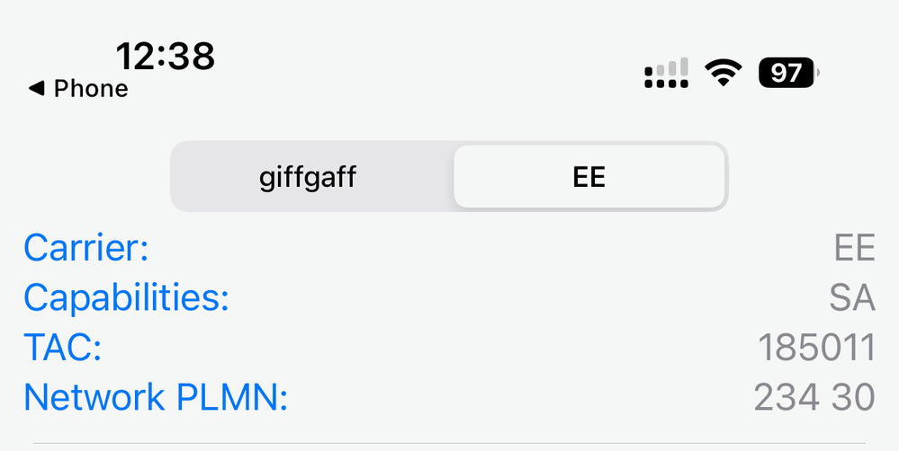

I've recently received 5G Standalone coverage here in Ipswich but the performance in my home is very poor compared to non-standalone.
I have also verified via iPhone field test that I am getting a standalone signal. When I do it's pretty much always two bars while NSA gets 4 bars. My phone also constantly switches between NSA and SA every few minutes.

Considering it was just made available here and my phone keeps switching between NSA and SA, is it still going through some testing? I noticed if I put my postcode in the 5G Standalone checker it still says not available even though I am getting a signal.

It says not available, but my phone is showing that it's receiving a standalone signal.

We have no active Stand-Alone service in Ipswich or the surrounding area at the moment. However, as our Newsroom article mentions it being available by the end of this month, it's safe to assume there will be and have been performing some testing in the area.
We don't have sight of any testing schedules that may be carried out, but once the service is fully active in Ipswich it would be good to then compare the service you receive. You should get faster download and upload speeds as well as better network performance in crowded areas.
Keep an eye on the coverage check link. If you have any issues once launched in the area you can get in touch with our technical team who can investigate.
