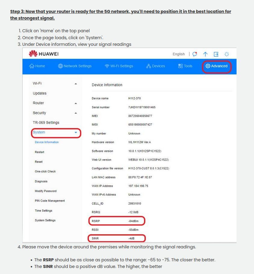

mtjwatts
RSRQ -8.0dB
RSRP -95dBm = Rubbish signal
RSSI -65dBm
SINR -1dB = Really low.
my rsrp usually - 80 dBm
Also read this on Huawei site.
18-02-2022 03:42 PM - edited 18-02-2022 03:44 PM
The Signal Strength Info that you have posted there is for 4G only.
RSRP of -95dbm ins't great but still well usable. Your unlikely to get the RSRP any better than around -80dbm unless your sitting on top of a Mast.
Is the 5G led on the front panel on?

Mines flying. All lights on etc.
That info come from a 5g trouble shooting page(Huawei) ...so maybe ??? It is wrong ???
I get varied numbers. depends how the routers feeling.
These gave me a speed-test of 828.66 Mbps Down 55.47 Mbps Up 11 Ping.
The router is sitting on my windowsill wired directly to pc by cat c and i can see the tower picks the signal from. Going to try other places to get a better signal........
RSRQ
-7.0dB
RSRP
-84dBm
RSSI
-63dBm
SINR
17dB
