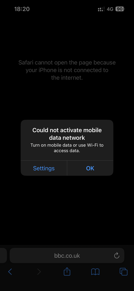

Hello,
I have an issue that my EE plan cannot make any cellular data connection. It used to work, then stopped. It's not dependent on location. I use my EE plan via eSIM on an iPhone 13 (2nd line).
Unfortunately as I am a business user (not the billing contact) my access to talk with EE is limited to organising a call with the bill payer (my HR department). Between them and EE (not) handling my troubleshooting well has meant no data since November 2022, and now (1st March 2023) 🙁
I wonder if something simple that I can try may help. Any advice appreciated, as it would be good to shortcut this before we make 1 year without a data connection!
I have tried:
- iOS software is up-to-date
- No carrier update is offered when I go into About.
- I reset Network Settings
- I manually selected the network
- I used MyEE app to download replacement eSIM onto my old handset, iPhone XR. Data worked! My plan is clearly OK.
- I used iPhone's transfer eSIM to put eSIM back from XR to my iPhone 13 and the data again broke.(I had deleted the eSIM before bringing it back).
- I repeated, eSIM back on to iPhone XR and then used a new QR code (from the app) to get it back to iPhone 13 and again data was broken. Seems the method of provisioning eSIM didn't help.
- I realise for some reason it isn't possible to see APN etc settings on iPhone so I can't check those.
Is it possible to force a carrier update via SMS at all?
All thoughts welcome! Thanks.

I have performed a full factory reset of my iPhone. (By the way I recommend backing up to a PC/Mac instead of iCloud because it is faster and you can encrypt the backup to include more data).
Unfortunately, even with all the re-installations, when I restored the eSIM onto he iPhone 13 I have the same error using mobile data - screenshot below. (I had the eSIM temporarily on the old iPhone, even for a few hours, and data worked fine, so clearly not account related).
Can I get carrier settings forced to my phone? Is there any merit in getting a physical EE SIM just to force some settings?
I am trying to get my bill payer in my company to enable me to talk to EE technical support but I'm not hopeful. The iPhone itself by the way is part of the EE business contract so I hope I can get some support with it.
