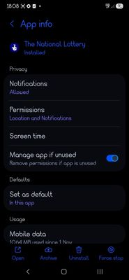

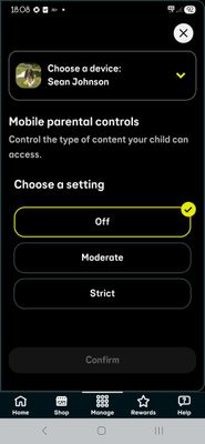

Hi I’m having same issues via app and search browser, I have relay turned off and app also has using mobile data turned on, I can’t access it whatsoever?

Welcome back to the Community, @Aidyd3.
Have you checked to make sure your content lock is definitely deactivated right now?
Also is it only mobile data affected, or broadband too?
Peter
Why do you keep regurgitating the same response? Multiple people have told you its nothing to do with a content lock! Its fine on WIFI but not on 4/5G.
Instead of repeating the same responses can you please be helpful and try and resolve the issue that many of us have
