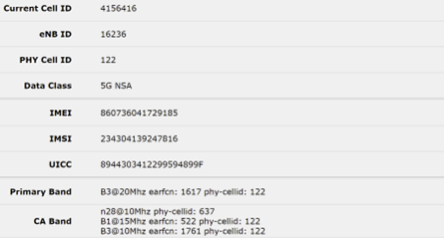

So if I've got this right, the second Pic details are of your old EE Router, if so your are correct the Site this Pic shows you are logged on to appears to be the main 5G Tower in the Area, which is approximately 1km SSEast of you.
A bit more info here -
Cell ID: 4156416
Actual Log On - B3 1800mhz, Cell Sector East Degrees
4G Bands Available at Site - B1, B3 and B20
Approx. Location - Aysgarth Avenue, Leighton, Crewe
When using the EE Router, you seem to using Bands 1 and 3 in Carrier Aggregation together with 5G NR Band 28 (700mhz) which as expected with your good Signal Strength and SNR provided you with good DL Speeds.
Ive checked your New Router Specs and it appears that the Mikrotik do cover All of EE's 4 and 5G Band that are currently being used by EE, so as all is correct there a bit unsure why your not picking up 5G, what Signal, Bands and Cell Site Info does the Mikrotik Router give you, and can you Post up All relevant info.
It may be possible that if your New Router is somehow only Logging on to EE's Band 20 this may explain lower speeds and possible lack of 5G.

OK..Here are some stats from the mikrotik router. To test this I am using my own 5G sim card by the way, not the SIM card in my main 5g EE router as I didn't want to take the system down to test things. The speed is still no better than 45MB download. When I test on my phone the speed is >270MB download. Massive difference in the Mikrotik router. Same SIM.
