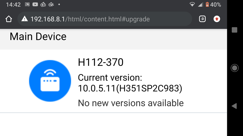

Recieved an update Yesterday
10.0.5.11(H351SP2C983)
Network Free Huawei 112-370, having said that apart from the IPV6 issue, which is resolved by using IPV4 Only, I don't seem to be having any Signal or Drop Out issues since owning the Device.
