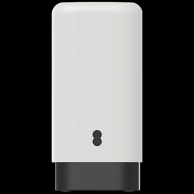

Which 5G Device?,  ie, Model Number? (Zyxel 5103 ?) currently on the EE Network you will need to be connected to a 4G Signal in order to benifit from an additional 5G Signal Layer.

Ok, thats the New 5G Router that EE are offering now over the 5103 for the past couple of years, really not familiar with the Newer Model, will need to explore but somewhere within the Web UI (192.168.1.1) it should give you a 4G/5G Connection Status?
This One?
