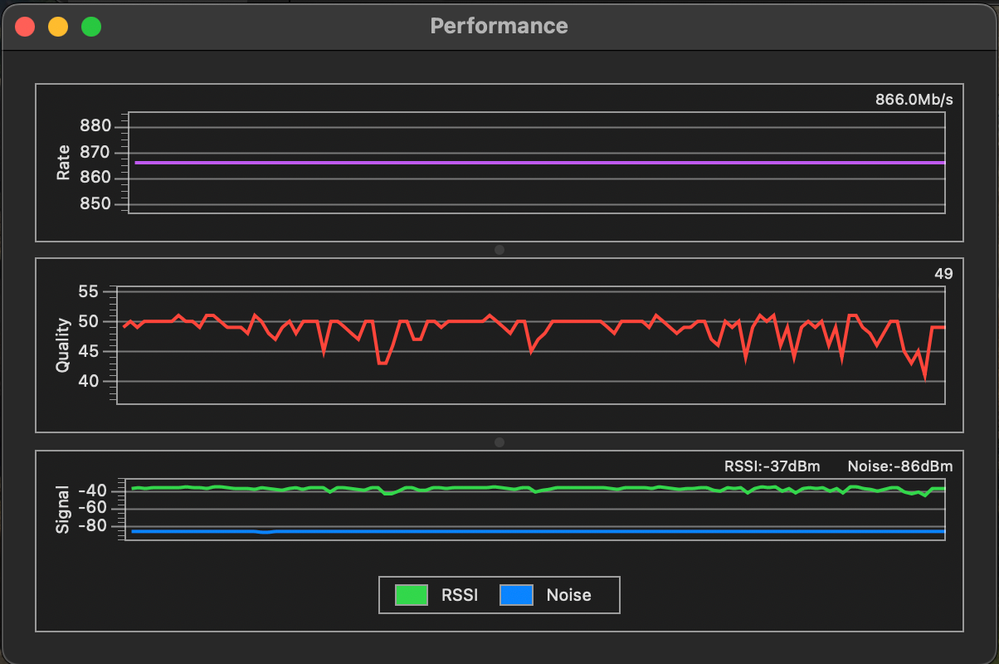

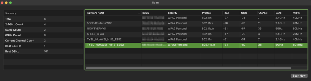

03-10-2023 10:53 AM
Are you asking me if I’ve changed Channels?
I have not.
In fact, as per my OP, the only change to anything I’ve made over the w/e was to update to the new Mac OS (not saying that’s the culprit, my issues could be purely coincident with this).
Do you reckon I should move to another channel (not entirely sure how I do that, but I'm sure Google can help).

03-10-2023 11:15 AM - edited 03-10-2023 11:15 AM
No. You're thinking of the wireless connection between the router and end device.
I'm describing some of the dynamics between the modem and mobile network that could impact on your issues.
