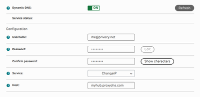

I'm confused by this distinction (bold). Logging into what exactly? When configuring Dynamic DNS for my ChangeIP account - which seemed to work OK last I tried - there's no option to select whether TLS is used or not? (details below obfuscated and not my actual account details)  🤔
