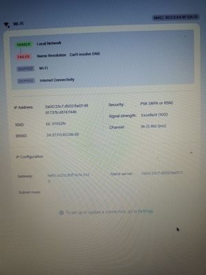

After revenge chromebook from the connected devices via app and reconnecting I now have connection but problem now with DNS on diagnostics tool.
Have logged into hub as administrator. My firmware is
r4.26.1-R-1860948-PROD-83002

 this is what happens when I run connectivity diagnostics tool
