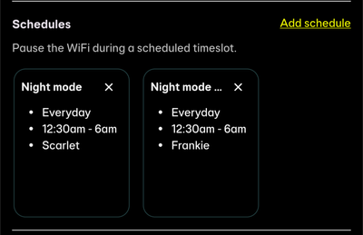

I have set up some WiFi schedules for my kids, but they don't appear to be kicking in. Is there something else I should be doing?

I just followed the instructions and I'm here, since doing this a couple of days ago the connections haven't been paused as all the devices are still showing as online during this period.
The kids aren't aware and wouldn't know how to work around this.
on 09-07-2025 09:30 AM
@yimmin Will take a look at your picture once it get's cleared for viewing, can you say what Router you have from EE link below so you can see the pictures, and if you have any smart wireless extenders on it.

on 16-08-2025 07:33 AM
The same has just started with mine as well - I've been using the schedules for ages and they've been brilliant, I've been telling all my friends with children to get EE.
But suddenly this week they stopped kicking in and I discovered my children still had wifi at 1am!
I was able to pause it manually but this isnt as convenient
