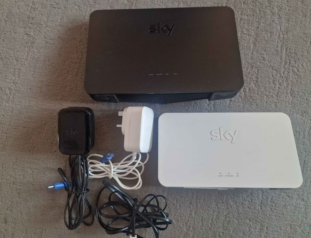

@Jason3249 What sky booster did you try to use? SE210 or one off the pods!

I push the wrong button **bleep**, anyway JimM11 the booster was this 👇🏻 that was my old set up 😀
Ta again XRaySpeX 👍🏻
