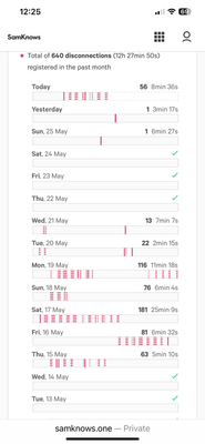

Cardiffjamesh
Established Contributor
OMG this is driving me nuts got 40 ish devices connected ee told me to remove some devices and not to use switches and only use one device on each lan port not practical I’m getting a 930 download on each cable no problems it’s disconecting wifi and lan
