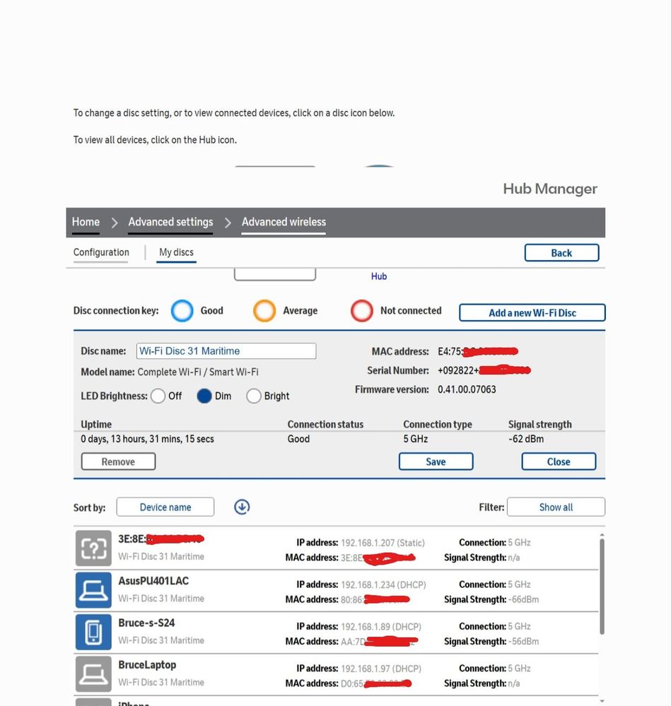

@Fjords_6 Do the advanced wireless and then onto the extenders to see what is specifically going on, picture linked below is a BT Smarthub2 version off the disk but you may get the idea.
BT Smarthub 2 extenders wifi backhaul connectedBT Smarthub 2 extenders wifi backhaul connected
