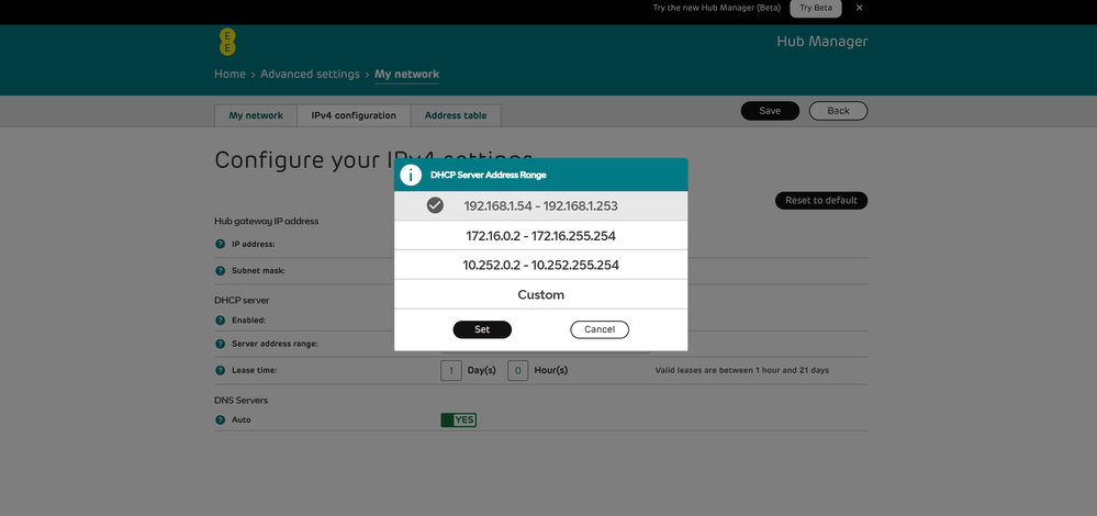

The default on the Pro is 192.168.1.54 - 192.168.1.253 most if not all of the routers i have owned tend to start & end around the same so i guess thats why im always fully outside the DHCP , as i keep the assignment numbers low always have ( 192.168.1.2 -192.168.1.15 & so on) so quite possibly this is why i have never fallen foul of ending up in the DHCP range , also there are 3 other options for DHCP range as below.
